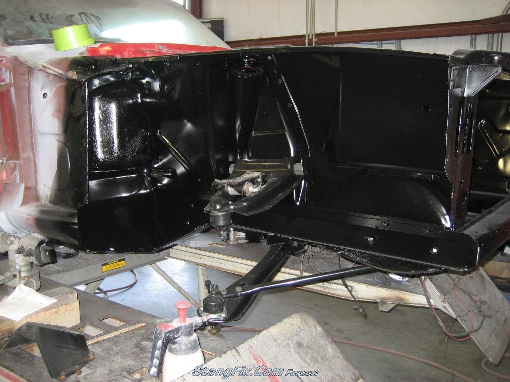

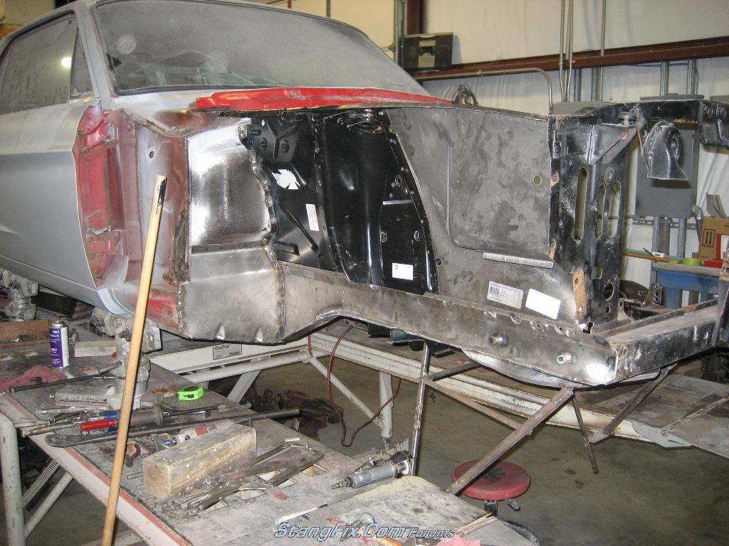

Dave, very few things are obvious to me with regards to this car. I want to do it right and due to budget (and present skill level), I'm willing to go very slowly. I'm still learning the names of the parts much less what and how to replace them.
So you're saying not this:
But this:
Actually, I assume that I'll need both?

From what I can tell, I think you need the frame support and frame extension. This will not be a simple repair, but should be do-able. I put new floor pans in my 66 coupe with very little previous experience. One thing to keep in mind is the positioning of the rails is very important. I would consider attaching some temporary bracing to keep everything straight during the repair. Do some research on uni-body repair to see if this is something you want to take on.
