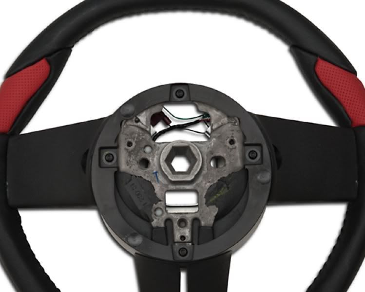

if this is what the center of your steering wheel looks like..
i could see a few ONE off  ways to create a telescopic adaptor..   but it might add an inch and a half or so to the lowest height..  and it will take some CNC work to machine it..
grant used to be a few miles from my house.. across from pete jackson gear drives..  i will do some drawings and drop them off when i am near there perhaps later this week..   i don't know how friendly they would be to outside ideas..
sometimes...  companies have a NIH attitude..   Not Invented Here.. although...   taking a stock USED steering column to a smart machine shop locally..  seeing if they could engineer up some kind of rotating cuff that uses ball  like a ball worm drive to extend the upper collar evenly..  using some kind of pins and guides to keep it from twisting.
could also be done a thousand different ways...
oh.. sorry.. when i get problem presented to me.. i can see ways to solve them..    cut 2 tin cans in half... one slightly smaller than the other.. so you have 2 shallow open cans that will fit into each other..  the inner one is the lower one and it has a single groove all the way around close to its base..   the outer one has multiple grooves at an angle..   there are guide pins to keep the 2 halves aligned..   there is another layer around the outside. this has the reverse of the angled grooves and a matching straight groove in a reduced diameter section..   there will be ball bearings trapped in the grooves..  many in the straight groove..  one each in the tapered grooves.. as you rotate the outer collar.. the larger of the two half parts is lifted by the ball bearings in the angled slots..   this would give you a telescopic adaptor..   the wires might need to be lengthened.. ... actually proper connectors and short adaptors made up..

I would think the easiest, and safest thing do to in this case is to have a billet spacer made between the column and the wheel, extend the horn/air bag wiring pigtail, and bolt the wheel and spacer down with a longer bolt. We're talking one to two inches thick, powder coat it black or cover it in leather or something and it should blend right into the column...

Essentially the spacer needs to have the back face match the back of the steering wheel and the front face match the steering column, this way the spacer will allow the wheel to lock into the spacer and the spacer lock into the column shaft. Then just secure it with a longer bolt (it's metric BTW). Of course, just like a spacer for an aftermarket wheel you'll need to have a pass through hole for the horn/airbag wiring. Luckily there are no contacts on the back of the wheel itself like an older wheel, as the airbag wheels keep the slip ring contacts under the airbag clock spring, which is the plastic assembly at the very top of the steering column with the wiring pigtail.

its probably going to have to be a 2 piece adaptor..  as you have to be able to attach it.. to the shaft.. so it will have a properly fastened lid for the wheel to attach to...   a cup with a lid...   the cup mounted to the column.. the lid to mount the wheel to.. not just held with screws.. but several alignment pins..  so the turning force is not just on the screws.. .. they can handle it.. i just like at least two pins ..
