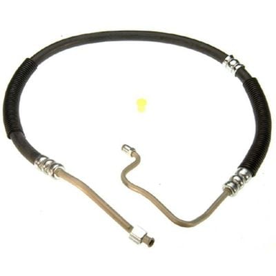

this is the 70653 hose used on 67 small block cars with 5/16 valve end size tube.

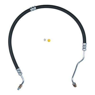

this is the 71180 from a 82 to 89 5.0 mustang application...  the right side in this image connects to the pump.

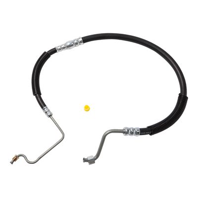

if your control valve has 1/4" tube .. this is the lower hose to use...  Part Number: 80025
Alternate Part Number: 70645 this is the old number..
if you intend on getting these hoses spliced together.. please.. be sure to mark the hose sections for alignment..  so you don't end up with a hose that has the wrong twist to it..
