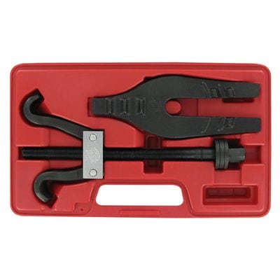

Just need to know if I need a ball joint fork tool...Dont want to start this until I have all the tools..Thanks

no...  you won't need a ball joint tool...

at AZ #27035 in the loan a tool section.. the fork tool goes on top of the shock tower.. at least thats the only way i have ever been able to use it.
at Oreillys #W80554
if you notice in the video there is a spacer below the hexnut on the shaft.. that is a galvanized pipe from the hardware store..    this reduces the gap between the two sections. without something like that.. you will run into the issue of the threaded bolt bottoming out into the spring perch...
you may also want to have a long 1/2" drive ratchet. or a ratchet head breaker bar to turn the spring compressor bolt...
hf item 67957

If it goes on top of the shock tower how will you be able to get the spring out? I was thinking that fork went in between the spring towards the top but under the shock tower???

the puller with 4 fingers  can be used to remove the spring.. with the compressor installed... then loosen the compressor bolt to free up the spring..  this is why you need a short section of pipe.. between the sliding finger section and the head of the bolt..
the puller with a FORKED tool has fingers TOO LONG to fit into the shock tower..  unless you intend on using a metal cutoff disc to shorten them..   you will still need a section of water pipe to prevent the bolt from going so far through the lower set of fingers and impacting the spring perch..
i actually have both sets of pullers.. i normally use the fork version.. with it sitting across the opening at the top of the shock tower.. .. pull the spring up...   remove spring perch..   release the compressor and the spring comes out..
insert the new spring with the rubber or urethane spring isolator at the top..  catch it with the spring compressor..  crank it up..  keeping everything centered.. so you are not pulling the spring to the side..  this is why i use the big prybar...  i actually use an electric 1/2" drive impact..   i sometimes have to help lever the spring into the proper position for the spring compressor to catch the fingers under the coils..

from about 4 minutes in to almost 6 minutes is the coil spring removal...
the forked tool is used instead of the neat disc tool...
i never though about using a NUT on the threaded shaft where it sticks through the fork..
i would use several grade 8 flat washers with grease on them to act as a thrust washer to make turning the nut easier..  be sure to use a Grade 8 nut..  and there are also extra thick and extra large hex nuts available in some hardware stores..

one more question,should I put the hooks in the middle of the spring or closer to the bottom?

probably half to 2/3rds down...  so you still have some threads to unwind to release the tension..

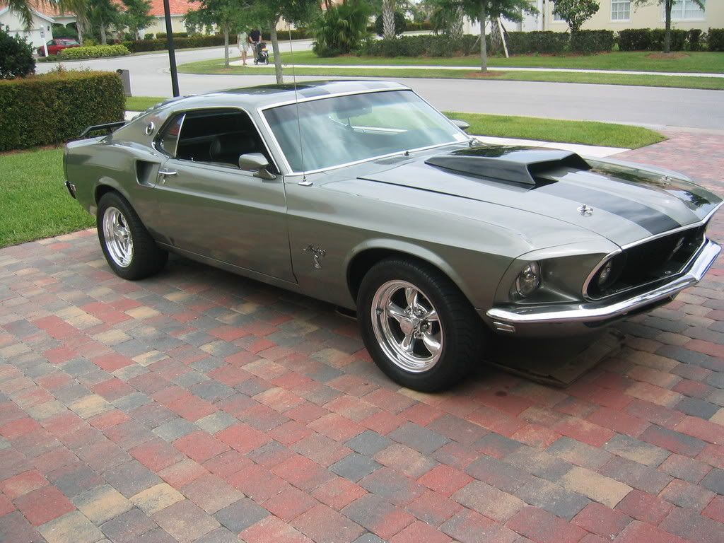

Right now I think the old springs are fully compressed due to age..The front is sitting low and if I get on it the front lifts up a lot,,,Normal driving sometimes I hear the front tires squealing..Funny that I replaced almost everything and never the springs,,What was I thinking!!!  The car sits in my garage and I take it out only for car shows,,,I redid the whole car and even stripped the paint off the entire car by hand before flat bedding it to the paint shop.I wanted to make sure the body was perfect and for the most part it was.
and my other toy,,,,as you can see I am a FORD guy.lol
funny.. the front end does not look low...
hmm... perhaps just slightly stiffer shocks...   the front end normally comes up when you get on it hard. usually because the back end is squatting as the leaf springs wind up and pull the back of the body downward..
how is your wheel alignment...    can you run your hands across the tires..  see if there is any abnormal wear.??     do you have real mustang disc brake spindles.. or granada disc brake spindles..   there are issues with the mustang front suspension with ackerman effect where the tires don't actually turn the exact amount needed.. so there is a slight squeal on turning corners on polished floors.. you may hear it..
do you have a GOOD wheel alignment shop in your area???  not a tire shop with young techs and computerized machines.... a middle aged guy with experience who only does wheel alignments all day long..
some of the tire shops have great wheel alignment techs.. but i worked at a major tire store in the early part of my working life..  i was told just get it on the machine and select the worst side and make it match the better side..
the problem is.. the amount of  range in the GREEN section on computerized aligners..
it can be half a degree.. between left and right.. sometimes more..   with the wider tires you have on your car.. there are specific wheel alignment settings that you are going to want to aim for to make it handle the best..
if your tires rub the fenders.. thats one thing.. i think you might be chasing ghosts....
what do the other forum members think of the ride height...
can you post a side image of your car..

I will try and find some pics...I know it doesnt look like its sitting low but you cant get the front end to bounce down at all.I mean I could jump on the bumper and nothing.Like its bottoming out.The tires squeal going straight..They are Granada spindles.I changed everything but the front springs..So now I just bought new shocks all the way around and new springs.
