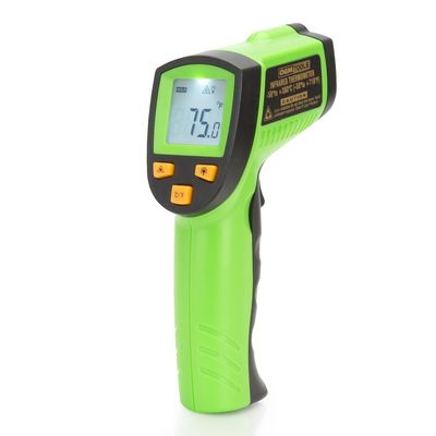

hand held infrared thermometers are cheep..
this is in stock at many parts stores..
OEM/Non-Contact infrared thermometer - Temperature range -31 to 689 degrees Fahrenheit
Price: $29.99 Part Number: 25245   harbor freight has versions for a few bucks more.. and for almost double. but you get 1100F max with the higher priced units..
