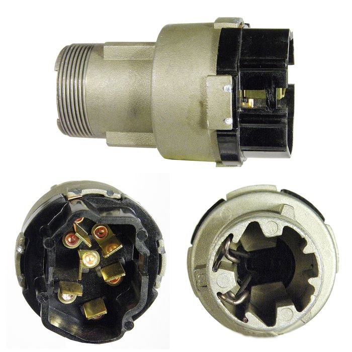

the back of the ignition switch looks like this..
but i cannot quickly find a connector for the pin type switch...

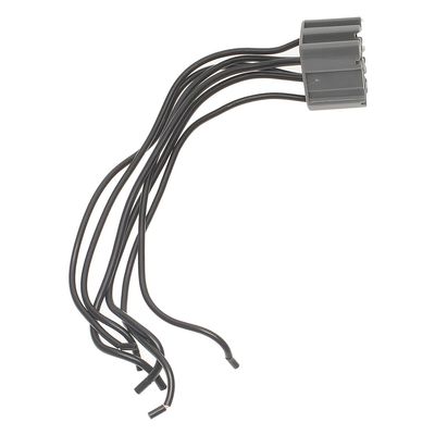

the later version used on pickups is an LS302 from AZ and the pigtail for that is available as a wells or AZ #485 ignition switch connector...
this is the LS302
this is the 485 ignition switch connector..
i even called wells..  they don't offer the pin type connector any more.. this LS302 and 485 connector end many of the melting issues that happens..
to get the lock out.. turn left to acc..push a paper clip into the hole just slightly till you feel it touch the spring loaded pin.. push ever so slightly and turn farther left...  the key will now turn just slightly farther left and pull the lock out of the FACE of the switch and bezel.. DO NOT turn the KEY while its out..   you will be sorry if you try.  it can come apart..
now you can loosen the bezel...  and proceed with the repairs..
hope this helps....

i took a look when i had the Chance...
the PIN OUTS are exactly the same....
in fact the switches are the same.. its just that one has PIN terminals.. and the other has modified pin terminals that hold the blade terminals....
so it should be really easy to ONE by ONE cut and splice the new connector to the harness..
please use a GOOD quality crimper .. like the Channel lock #909 pliers..  take a look at the channel lock 909 in almost any hardware store so you know what i am talking about..
