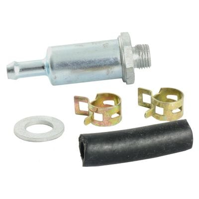

just curious... are you talking about the fuel filter at the front of the carb ????
do you have a holley  or a autolite or a carter carb????
autolite/motorcraft carb filters looks like this...
this screw into the front of the autolite/motorcraft 2100/2150 carb fuel filter does NOT get a gasket as far as i know..  its tapered pipe thread...   please do not over tighten it..
i have used a very carefully applied double wrap of teflon tape.  that i put on looking at the end of the threads in the clockwise direction but starting at the SECOND thread .. so there is little chance of any of the teflon tape from getting into the fuel system. as it will create all kinds of problems..
i have also used a tiny amount of hylomar  sealant on the threads... but again a TINY amount.. so it does not get into the fuel system and really screw it up...
or the fuel filter on top of the fuel pump.. that looks like this.

hi there...yeah, I was talking about the fuel filter as shown in the top photograph...the autolight/motorcraft...looks exactly like that and screws into the front of the carb.
Unfortunately, I tightened that thing down as tightly as I could. I had it much looser and it leaked, so cranked it down and it leaked a lot less, but still leaked nonetheless. It's a brand new filter that I put on and it looks like it is the exact perfect on for my carb. My carb leaked before though as well; but I can't recall if it was from bad seals or also from the fuel filter. At least now the rest of the carb is non leaking; just the filter.
Is this normal then? I don't recall seeing a washer there before either....but it would seem that it should not leak from there.
Is this a common problem? Is my only other option really to put on tape or fluid onto the screw end?

at this point.. if you have cranked it in too far and expanded the carb side of the tapered joint..
you will want to examine the face of your carb to verify you have NOT split the opening..
you might end up needing to add some kind of sealing washer in there..
there are sealing washers for drain pans.. that have a rubber ring molded to the inside of the copper or aluminum washer.. so reduced torque is needed to seal the drain pan plug to the pan..
i don't know if there are any that are CLOSE TO the proper size..
its a real big issue as we are working with GASOLINE... and any leaks in this area are very close to the COIL and the distributer cap.. where there is active arcing going on inside..
fords are well know for fuel fires under the hood.. fuel leaks from damaged screw in fuel filters.. leaking fuel hose sections..  overflowing carbs..
Have you TRIED more layers starting at the SECOND thread of teflon tape...
