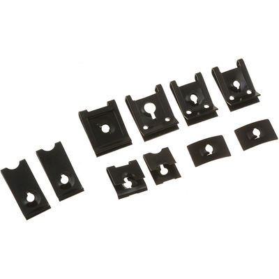

Who sell the spring nuts that go on the head light assy?http://i972.photobucket.com/albums/ae203/wlcornelius54/100_2090.jpg

most parts stores have carded displays of variations of these U nuts..
you need to identify what size/diameter screws you have...  #6, #8,     #10,   that hold your parts on...
you will also need to be selective of how far from the  edge the center of the hole is...  how thick the metal is you are putting the clip over..
for exact replacements..  you will probably need to pick up your restoration parts catalog... as they will be listed..
