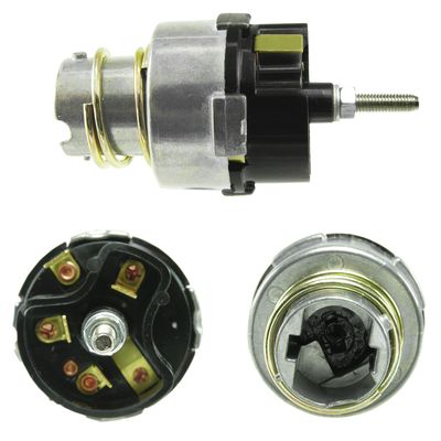

chances are that you might also have a bad ignition switch...

well.. you can start replacing parts instead of diagnosing probable issues...
ignition switch... is a probable.. issue..  they do go  bad... thats why parts stores keep them in stock..
you could also have loose terminals in the ignition switch socket..
