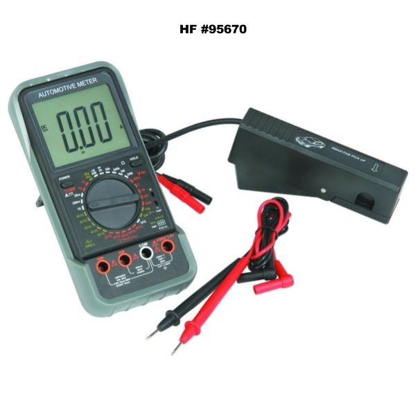

now.. if you intend on working on cars...  you are going to need a few basic tools...
do you have a harbor freight tools near you ..  this is their automotive volt and dwell meter. has enough automotive range settings that this is probably all you will need...  item 95680 normally the same as you paid for the spark plugs. i see this week knock 10 bucks off that..
