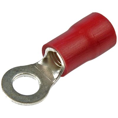

start with a stainless steel wire tooth brush with a wooden handle from the hardware or paint store.. under 5 bucks...
you will also want to take the terminals off the battery positive side of the starter relay and wire brush everything... count wires before taking off.. count as you reinstall them..
i had to fix some grounds on a 97 tbird.... ugly i know...
one of the wires to the fan was 8 gauge... used BIG terminals from the parts store...
red or pink is 18 to 22
blue is 14 -16 gauge
yellow is 10-12 gauge
big  red or pink is 8 gauge..
Dorman/Conduct-Tite 8 gauge 1/4 in. ring terminal Part Number: 85246
most parts stores also sell gold plated 1/4 and 3/8, 8 gauge ring terminals ...
you may need to extend some of the wires also..
Dorman/Conduct-Tite red butt connector for interior connection Part Number: 85264 Type: Butt Connector 8 Gauge
anything else thicker is battery cable ring terminals..
