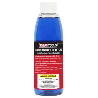

I also had thought about that, and have gone to every auto parts store around here as well as sears. And they know what I'm looking for but it shows them not being available as if they were discontinued. So if anyone knows where I can get one of those let me know. I will continue to test and post my results as they come in-thanks again for the help

some parts stores still sell the combustion leak testers.,

Hey guys update. All the above local stores could not get that tester. I got in touch with matco and they are sending me one that should be here on monday. I also found my bypass hose has a kink in it. Small but I put a new one on anyways to be sure. I also checked and th e head gasket is on correctly by looking at the tabs. I did compression test and they are all even but not leakdown. But since I have that tester coming ill just use that. By the way I put a mr gasket 180 thermostat in too.  Still think its wierd I was running colder but my rebuikd is syill pretty fresh so i dont believe to have any gunk in there. Weather has been crappy so ill have to wait a couple days to take her for a ride. Thanks again for all your help. I will postmy findings.
Posted: 01/17/13
09:15 AM
just to help out forum members get past the WHAT? question from the counter men...  the fluid is a BUY... but the block tester at least at my local az are in the loan a tool section behind the counter.. jot down the part numbers below..   the 25 you get back when you return the tool clean and complete..  you get to keep the fluid...
OEM/Block Tester Test Fluid
Part Number: 25739
Price: $7.99 at az
OEM/Block Tester
Part Number: 27145
Price: $25.00
might be the same part numbers at some other stores...
