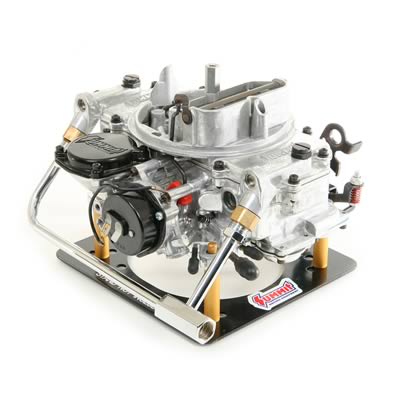

summit overs their summit carbs.. that are actually holley model 2010 and 2011 models.. they are direct grandchildren of the autolite 4100 carbs... except that summit offers idle feed restrictions and air bleeds as replaceable ...

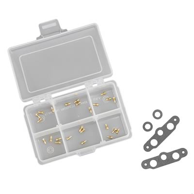

you can get the idle feed restrictions for them also...
These S brand idle feed restriction tuning kits are designed to fix low-end drivability issues, such as black smoke, poor fuel economy, and surging at idle. They include four each of 0.043 in., 0.046 in., 0.049 in., 0.052 in., 0.055 in., and 0.059 in. idle feed restrictions. These S brand idle feed restriction tuning kits also include two nozzle bar gaskets and a detailed instruction sheet for easy installation.
