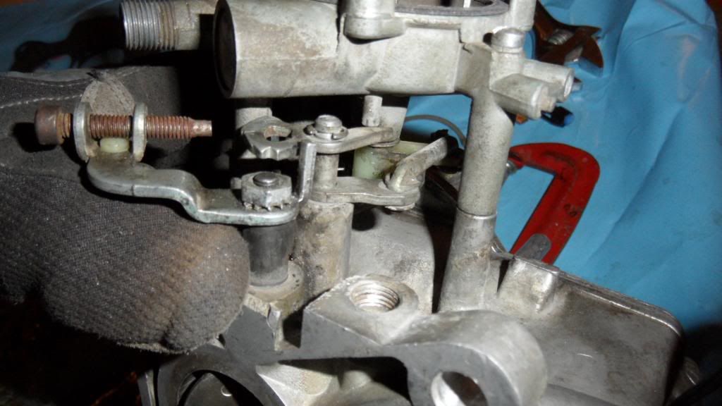

http://i1311.photobucket.com/albums/s673/jford62/SAM_3671_zps94dfdee2.jpg
for the images of the choke
I realize the fast idle lever is not in the right position, yet I am not entirely sure how to fix it. I should add that I am a novice mechanic.

that does not look wrong...

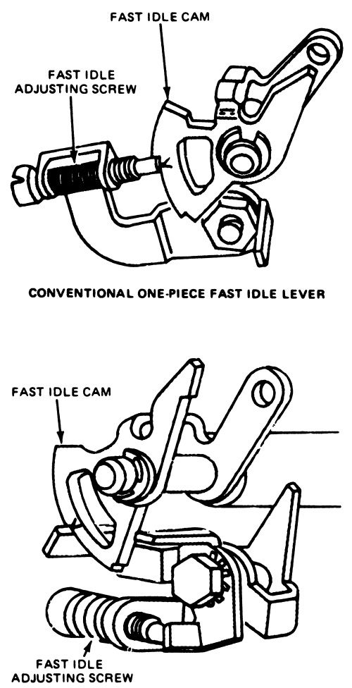

i had a thought...  you might not know.. that the choke won't close unless the throttle is opened to release the fast idle cam steps from the end of the fast idle screw.... that involves a partial opening of the throttle that also operates the accelerator pump to richen up the start..
now.. look at the other end of the lever with the fast idle screw... do you see the bent end... when you open the throttle more than about half way.. that levers the fast idle cam OPEN ...
this makes sure that the choke can be opened if you get in and hammer down on the throttle with the choke still closed. .. it also allows you to force the choke open to clear a flooded motor..
