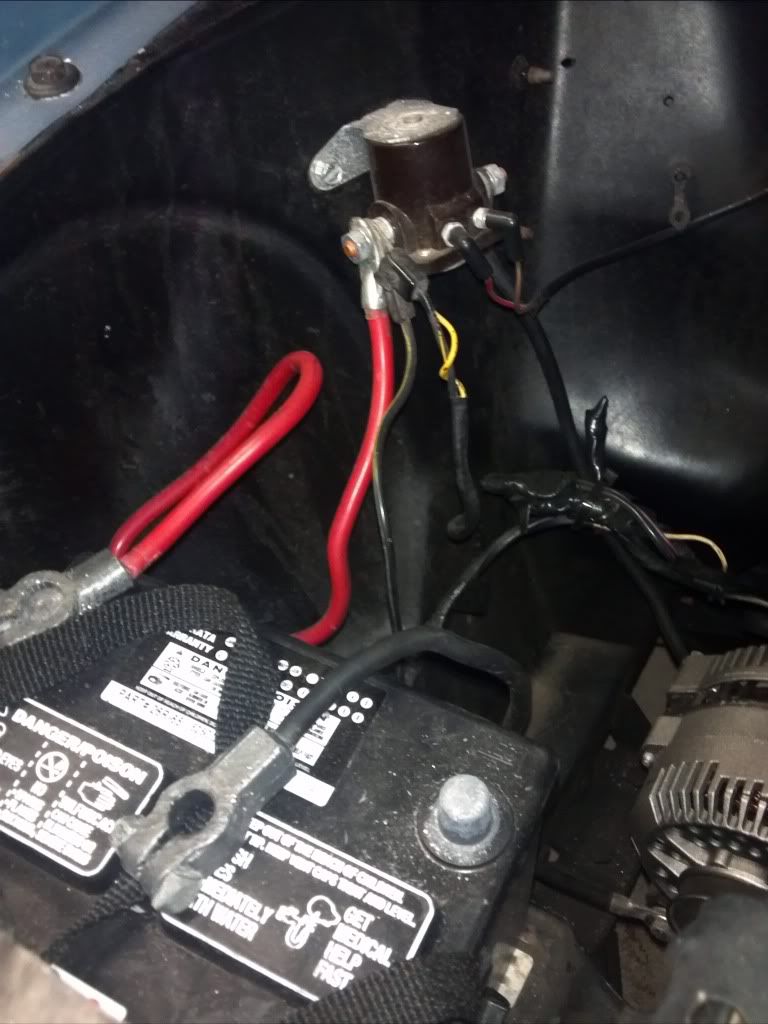

here is an image of the starter relay... you can see the yellow wire twisted around the black and yellow wire.. the black and yellow powers this circuit..   the yellow wire goes to the other side of the amp meter...  and supplies power to other circuits in the car..
the thicker black and yellow wire next to the red battery cable goes to the 3G alternator you can see in the lower right of the image above..
